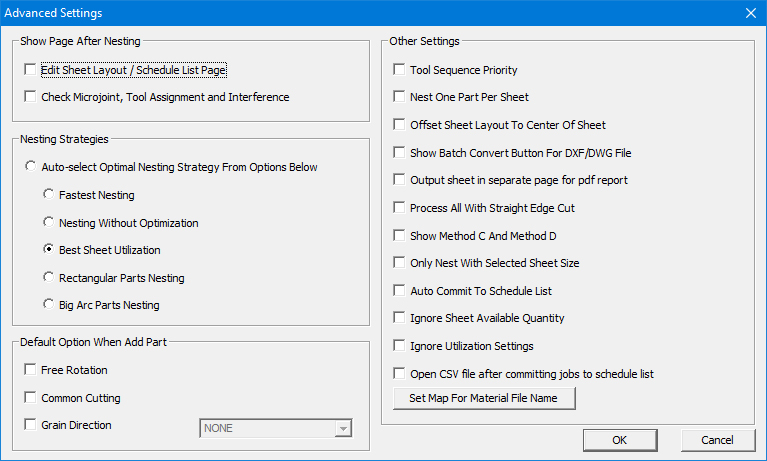

Advanced Settings
Show Page After Nesting
Check ON Edit Sheet Layout / Schedule List Page to have the Edit Layout panel and Schedule List option display immediately after a sheet or job is nested.
Check ON Check Microjoint, Tool Assignment and Interference to have the program run a check on these items. The Problems Encountered Window appears with info on problems that occurred with the nest.
Nesting Strategies
Select a nesting strategy for the job. Methods (numeral designation in parentheses) display in the Choose Nesting Results window in the Method column.
Auto-select optimal nesting strategy from options below (-1)
Select this option to allow the program to select the optimal nesting strategy for the job.
Fastest Nesting (0)
Optimization for polygon lines; this method is the fastest, but is less accurate.
Nesting Without Optimization (1)
Optimization for polygon lines is turned OFF; this method is about 10% slower than Method 0, but is more accurate.
Best Sheet Utilization (2)
Grids are first nested on the sheet, then spaces between grids are merged and parts are nested in larger spaces. This method is suitable for jobs with many parts, which can be nested between grids and in part holes. This method has a superior filler ability and usually results in the best utilization of the entire sheet.
Rectangular Parts Nesting (3)
This method for large regular parts is used to nest parts with minimal nesting in open spaces.
Big Arc Parts Nesting (4)
Uses a bottom-left algorithm on the entire sheet. This method does not nest grids, as it is only suitable for large arc parts.
Default Option When Adding Part
Free Rotation
Check ON to have rotation become the default for loaded parts. The user can override this by manually making a change in the Rotation column in the Parts List. Note: This option doesn't apply to grouped parts.
Common Cutting
Check ON to have common cutting become the default for loaded parts. The user can override this by manually making a change in the Common Cut column in the Parts List. Note: This option doesn't apply to grouped parts.
Grain Direction
Check ON to set a grain direction for loaded parts. The user may manually adjust this setting in the Parts List.
Other Settings
Tool Sequence Priority
Check ON the Tool Sequence Priority option to view all of the tools that are used for the Nesting Job. The option is only active after the parts are prepared for nesting.
When a selected part associated with a group of parts is nested, all the parts within the group are highlighted. The Tool Sequence Priority window opens when Start Nesting is selected, displaying all the tools assigned to the parts in the nesting group. If necessary, modify the order of any tool in the window before processing the nesting job.
See Tool Sequence Priority Window for more info.
Nest One Part Per Sheet
This will nest one part on one sheet. Used only for very large parts that will use up all or most of a full sheet.
Offset Sheet Layout To Center Of Sheet
All parts or a part will be nested in the center of the sheet. Other parameters such as distance between parts still applies.
Show Batch Convert Button For DXF/DWG Files
Check ON this option to have the Batch Convert button appear on the Load Parts window. This allows the user to convert dxf/dwg files into AP100US-compatible .prt files, which can be immediately loaded into the Sheet Wizard Parts List for Nesting.
