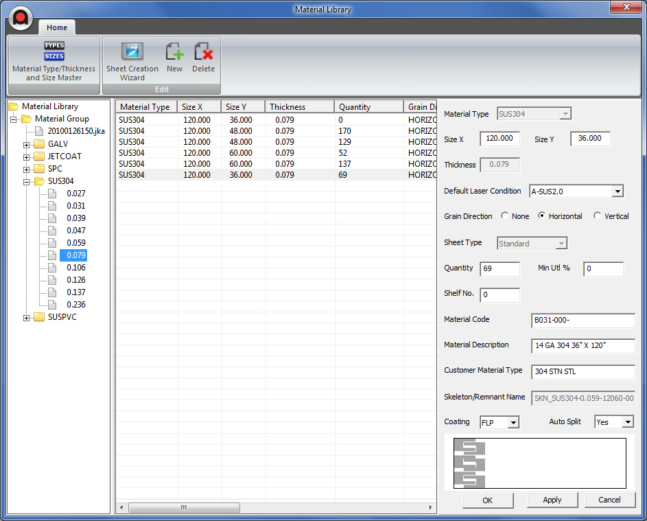

Material Type Editing options
Material Types may be edited as needed. The Material Type, Thickness and Sheet Type columns are read-only.
Minimum Utilization %
Min Util % controls nesting job output based on the percentage of the sheet that is filled with parts. If this value is not met on one or more sheets in the job, AP100US will not output those sheets in the nesting job.
If there are several sheets in a nesting job, the last sheet is often only partially filled with parts. In previous versions of AP100US the last sheet was still processed, meaning that material would be wasted.
60% entered into the value field means that if parts occupy 60% or more of the sheet it will be kept in the job. However, if less than 60% of the sheet is filled with parts, the sheet will be ignored by the system and renested later.
If the field is left empty or 0% is entered, then all sheets in a job will be processed even if one or more sheets are not filled with parts.
Material Code, Material Description and Customer Material Type
Descriptive information of the material. Material Code specifies the type, thickness, and size of the material to nest a part on. This info must be entered by the user, or these values may be predefined by the user's ERP/MRP system.
Skeleton / Remnant Sheet Name
A skeleton or remnant sheet is a partially used sheet, which has enough unused material left that it may be recycled again in another nesting project.
To designate a sheet as a skeleton or remnant sheet, the user must first enable the Skeleton option in the Machine & Turret>Sheet Info panel. After nesting a job in the Sheet Wizard, the program will automatically select and name a partially used sheet that may be reused as a skeleton as shown here -
Note: The Remnant name may be customized. For more info see Sheet Wizard>Settings>Report Settings.
Click OK in the dialog to confirm and the new skeleton sheet will be made available in the Material Library interface as shown below -
The sheet thumbnail on the right shows the size of the sheet and
the amount of the sheet that was already used in a nesting job
The name of the skeleton sheet is assigned by the system. SKN (skeleton) is followed by the material type, size of the sheet and unique version number (0001).

Coating
Select from NONE for uncoated material, FLP (Fiber Laser Plate) for material made for use with a fiber laser machine, PVC protective surface coating or 2 SD for two-sided PVC coating.  If parts are added using the Add feature, these fields will be marked NONE. This column is hidden by default; right-click a column header to show the flyout menu to switch on the column.
Auto Split
To have the program automatically place splits on the sheet(s) in the Sheet Wizard, select Yes. Parameters for the splits are pulled from the Split Sheet Settings in the Material>Process Type Panel>Split Sheet tab. To open the Material panel from the Sheet Wizard, use the Setting Buttons at the bottom of the Settings window.
Sheet Thumbnail
Displays a thumbnail image of the currently selected sheet parameters. If the sheet selected is a Skeleton sheet, the image will show sheet usage.
