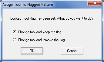

Locked Patterns
When attempting to assign a tool to a pattern that has been locked, the system will prompt for further action. The user may choose the Change the tool and keep the locked pattern property, or change the tool and remove the locked flag from the pattern. (See Assigning Locked Tool Flags.)

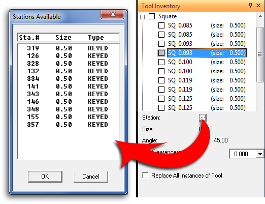

Tool Inventory Properties Window
When you use the Assign option, the Tool Inventory properties window will appear. The fly out window will list the tools you can apply to the patterns. You can determine the station assignment and size, and choose the angle and die clearance for the tool.
Note: When assigning Special Tools to a part from a Tool Inventory or placing (special) Tool Hits, any Special Tools from the Tool List which do not have an *.SPT file in the Special Tool folder will be grayed out.
Tool List
The Tool List in the Tool Inventory window will display the tools that are in the currently loaded tool inventory. If you have selected From Turret on the Tool menu, the Tool List will display the tools currently loaded in the turret stations.
Station
In the Tool Inventory window a navigation button appears next to the Station label if a selected tool has not yet been assigned. Click the button to assign the tool to a specific station in the turret. The Stations Available dialog will list all the empty stations that are that are suitable for the selected tool. Click the desired station and then click OK. Move the pointer into the work area and assign the tool.
Note: If the tool you are assigned has a preferred station, that station is selected (highlighted) when the Station Available window appears. You can click OK to use the preferred station or select a different station and click OK.
