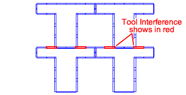

Show Tool Interference
To have the program show interference between tools, check ON the Show Tool Interference option.
Note: The color used to hi-lite tool interference can be modified in the Preferences>Color & Style Parameters>Item Color panel.
This option must also be enabled in the interface by using the Tool Interference options on the Tool Assign tab.

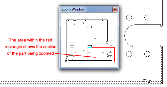

Show Zoom Window
Check ON this option to control the display of the Zoom Window.
