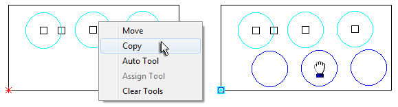

Flyout Menu
After selecting Easy Edit, right-click any active pattern to display the flyout menu. Select Copy (shown here) or Move.
When a punching machine is loaded, tooling may also be assigned to active patterns.
