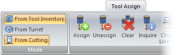

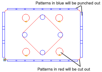

3. Select Mode
Be sure that the From Tool Inventory and From Cutting options on the Tool Assign tab are selected. This allows the AP100US program to select punching tools or cutting tools as needed. (The From Turret option will be inactive if no tools have yet been assigned.)
4. Assign Tooling
On the Tool Assign tab select Auto Part to have the program assign tooling. Tool assignment depends greatly on the tools in the current Tool Inventory and various other settings in Preferences>Tool Assignment and Preferences>Tooling.
