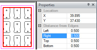

Select this option to create a part kit. It is ideal for small parts that may accidentally get dropped between the slats on the cutting table or are too small for automatic part removers to handle. Box Frame Kit creates an outer boundary for the part kit that will be recognized by the system and cut out along with the parts in the kit themselves. A part kit with small parts (such as in the image below) may become unstable during cutting and removal; for this reason it is recommended to add microjoints or tabs to the parts in the kit even if they are not used on the overall sheet. Such microjoints will connect the parts to the skeleton that is within the kit boundaries.
The pink outer line boundary for a Box Frame Kit constantly remains in view
When a box frame has been dragged out and finalized, enclosing the parts, the box frame Properties flyout appears (shown above). Left-click in any "values" field to highlight the value and manually enter a new value. Hit <Tab> to finalize the entry and jump to the next field.
Move the part kit box (including parts) to any part of the sheet by entering values in the Location fields.
The size of the box itself can be controlled by entering values in the Distance from Edges fields.
Note: Working with other options on the Sheet menu will close the box frame Properties flyout (if open) and open the Sheet Properties flyout.
