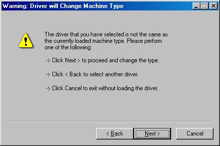

Click Next > in a Change Machine Type dialog box to proceed to the next step.
Click < Back in a Change Machine Type dialog box to return to the previous step.
Click Cancel in a Change Machine Type dialog box to cancel the loading of the alternate driver.

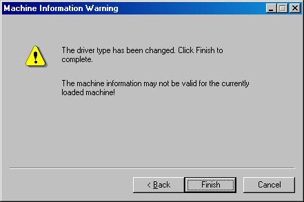

Notes: The machine information may become invalid after you select an alternate driver. Check the parameters, and if necessary, save the machine file under a different name.

Select a cutting machine driver and then click Open. The Change Machine Type dialog box appears.
Click Next > to continue. The Cutting Machine Driver Selected dialog box appears. The selection of a cutting driver will remove the punching and combination conditions and features from the part or sheet.

Select the option of your choice and then click Next > to continue. The Machine Information Warning dialog box appears.
Click Finish. The alternate cutting driver is substituted for the default driver. Notice that Cutting now appears in the Machine Type field.
