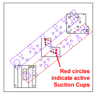

Click a part on the sheet to display the part remover arms directly over the selected part. (If necessary, double-click the part to zoom in.) If Auto Detect has been checked ON in the TK/PSR Settings window, the suction cups will activate when they are over the part. If Auto Detect is NOT checked on, then the user must activate suction cups by clicking on each cup over the part to be removed.
Note: If a PSR machine is loaded
Be Careful! Only suction cups directly over a part should be checked ON. If extra cups are checked ON, the part remover arm may also attempt to remove the sheet skeleton!
If Rotate Unloader is checked ON in the TK/PSR Settings window, then the arms may be rotated to any possible angle as shown below. Just place the cursor between the arms, left-click and drag the arms to rotate.

Left-click and drag with the cursor over the lower arm and both arms can be moved together. Left-click and drag with the cursor over the upper arm and it can be moved independently. To finalize the settings for the part remover arms, right-click once.
Arm position, angle, pickup positions in X/Y, Last Cut/Punch and arm distance in X/Y can be configured in the Properties dialog that displays when the arms are active.
