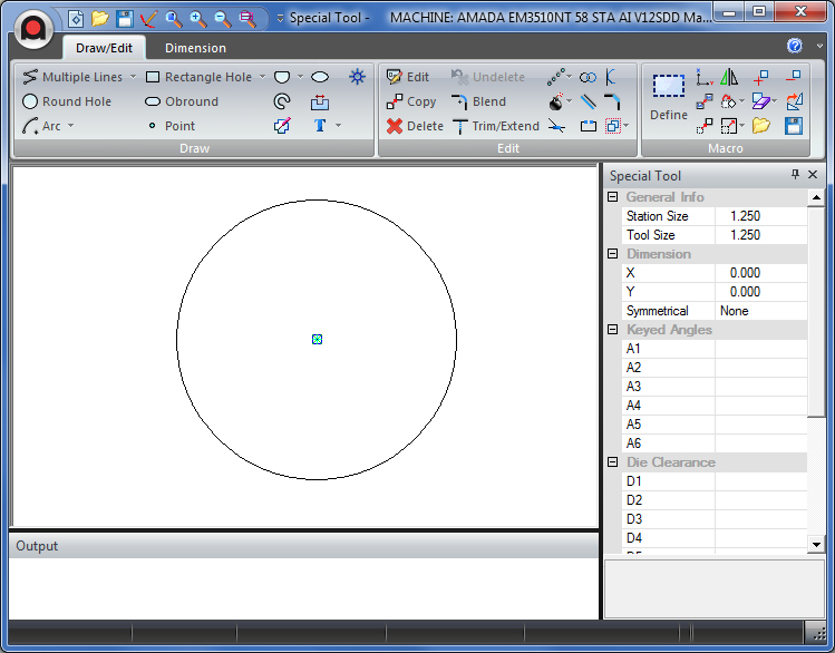

		To draw a special tool, select Design Special Tool from the Special Tool submenu to open the Special Tool Designer window. The window displays a circle having a reference point at its center, and the Special Tool Information window. The circle represents the actual tool size. If you modify the Tool Size value, the circle resizes accordingly only after you place patterns within it. The Tool Size parameter is saved with the special tool. Note: The system automatically begins a new special tool each time you start the Special Tool application. Note: When defining a Special Tool and assigning tools, AP100US can snap not only to the default point, but also to an additional point placed by the user. Note: Changes saved to a Special Tool in the Special Tool Designer module will automatically be passed to the Tool Inventory. The Draw/Edit/Macros and Dimension menus function as they do in AP100US.
		If the Special Tool properties window is not open, click the Amada "A" to open the main Special Tool menu. Click on Special Tool info as shown in the image.
 Use the Special Tool properties window to define the tool. The window disappears if you select another option. Open the window by selecting Special Tool Info in the menu bar. You can draw the tool after you have typed all the values. When defining a special tool, the system should use the overall X and Y values of the Define box and transfer them to the X and Y values in the Dimension fields. This will at least give the user the overall size of the tool. Notes on snapping to points: The point or pattern in the Shape Definition can be used as the Center of the Tool. Actual coordinates can be entered in the Coordinates panel when placing a snap point on a special tool. It's also possible to manually place a snap point by selecting Draw>Point and then clicking on the part and editing coordinates in the Pattern Properties panel that displays on the right side of the work area.
 Note: When a Special Tool is edited here in the Special Tools Designer, changes made will automatically be updated to the Tool Inventory.  |
