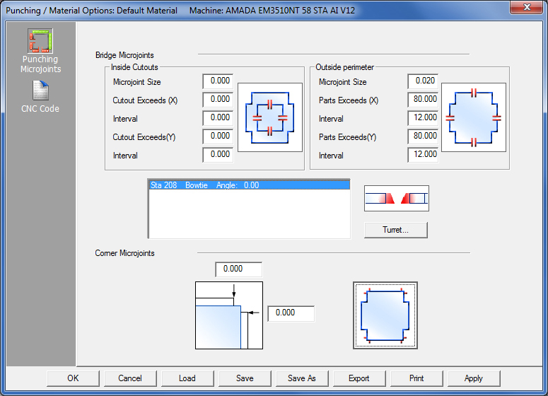

Bridge Microjoints
This section allows the user to specify the default size of the microjoints, the quantity of the microjoints and the criteria for applying the microjoints at intervals according to the overall length and width of the part(s). These values can be applied to Inside Cutouts and the Outside perimeter.
Inside Cutouts Size and Interval Criteria
Configure placement criteria for Inside Cutout microjoints based on part width and length.

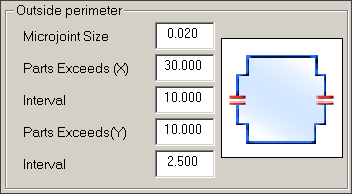

Sample Microjoint Placement
Outside Perimeter Size and Interval Criteria

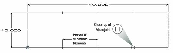

Microjoints applied to a 40 x 10 part with a microjoint size of 0.020 -
In the sample given above, the value in Part Exceeds (X) is less than the size of the part -  Part size = 40.000, Part Exceeds (X) = 30.000.
In this case, the program will ignore the Preferred Locations Toggle and place microjoints on the part according to the user-entered value (10.000) in the Interval field. Notice in the diagram how microjoints in X are placed at intervals of 10.
The value in Part Exceeds (Y) is equal to the size of the part - Part size = 10.000, Part Exceeds (Y) = 10.000.
In this case, the program will ignore the value entered in the Interval field (2.500) and place single microjoints on both sides of the part according to the assignment selected in the Preferred Locations Toggle.
The Inside Cutouts section also functions in this way.

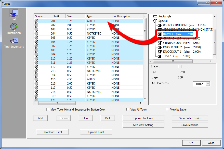

How to Select a Microjoint Tool
Click the Turret button to open the Turret List window. From there it is possible to select a microjoint tool.
Turret List window
Drag the selected tool into the station on the left
Click the Add button to open the tool list that displays on the right side of the Turret List window. Be sure that View All Tools is checked in order to turn off any filters and display all tools in the inventory.
See Turret Window - Tool Inventory View for information about adding a tool inventory.
In the pane on the right, select a tool to be used as the microjoint tool. In the example above Bowtie is selected as it is commonly used as a microjoint tool. Drag the selected tool into the Turret List on the left. Stations that have the correct size and are suitable for the selected tool will be highlighted in blue. A microjoint tool may be placed in an AUTO station, which will allow the tool to rotate as needed.
When the preferred tool is in the Turret List, double-click that tool and the Station dialog box displays. Make changes to the values for the tool in this dialog if needed.
See Creating and Editing Stations for more information.
In the Station dialog, click the Info button and the Station Tool Information dialog box appears. In this dialog, select Use for Microjoints to designate the selected tool as the Microjoint tool. Click OK to save changes and close the dialog.

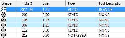

Back in the Turret List window
When the Use for Microjoints is checked, the tool will show the letter “M” in the Station # column in the Turret List window as shown in this illustration.
Station #201 will be used for the Microjoint
tool, as indicated by the letter “M”
Click OK in the Turret List window to return to the Punching Microjoints window. Click Apply to apply the microjoints to the part(s), and then click OK to save any changes and exit the Punching Microjoints window.

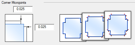

Corner Microjoints
The Corner Microjoints section of the Punching Microjoints panel allows the quantity of corner microjoints and the corner distances to be specified. Move the pointer onto the graphic and click the left mouse button to toggle through the microjoint assignments. There are three possible settings: No corner microjoints, four microjoints and corner microjoints applied to all adjacent 90-degree corners.
Note: The value fields become active when the second or third options are selected.
