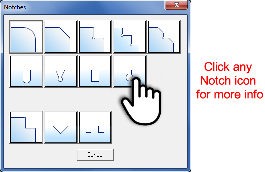

The Notch Library option on the Draw submenu allows the user to apply notch patterns to intersecting lines that comprise the part boundary. Create a basic notch or chamfer, or complex multi-notches, U-notches and V-notches. Select the Notches icon to open the Notches window shown here -
      Each icon represents a notch type -
Fillet
Chamfer
Basic Notch
Multiple-Notch
Chamfered Notch
U-Notch
V-Notch
Box Notch
Key Hole
Regular Corner Notch
Regular V Notch
Regular Multiple Notches

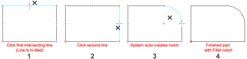

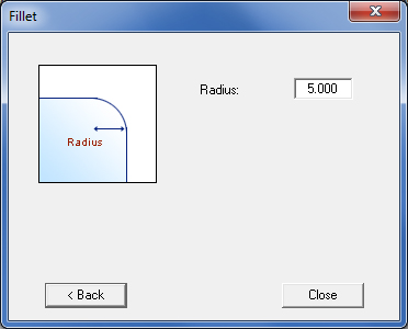

Fillet
Click the Fillet button in the Notching window to create a fillet or corner radius. You can specify a radius range of 0.001 to 1000000 in the Fillet window. Type a value in the Radius text box and  the system will prompt you to select two intersecting lines. Move into the work area and click each line in succession and the system will apply the arc and trim the lines. Important: When placing a notch DO NOT close the Notch window.
Radius
Type a value in the text box to specify the radius.
Back / Close
Click the < Back button to return to the Notches window to select a different notch type. Click Close to exit.

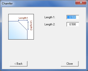

Chamfer
Click the Chamfer button in the Notching window to create a chamfer. Specify the distance from the intersection point by typing values in the L1 and L2 text boxes respectively. Specify a range of 0.001 to 1000000 in the L1 and L2 text boxes and the system prompts you to select two intersecting lines. Move into the work area, click each line in succession and the system will apply the chamfer and trim the lines.
See Placing a Notch for a basic example.
Length 1
This value is where the chamfer begins on the first line.
Length 2
This value is where the chamfer begins on the second line.
Back/Close

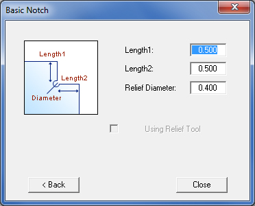

Basic Notch
Click the Basic Notch button in the Notching window to create a basic notch with a relief hole. Specify the distance from the intersection point by typing values in the Length 1 and Length 2 text boxes, and the diameter of the relief hole in the Relief Diameter text box. You can specify a range of  0.001 to 1000000 for Length 1, Length 2 and Relief Diameter. As an alternative, you can specify a round tool to create the relief hole by placing a check mark in the Using Relief Tool check box. Move into the work area, click each line in succession and the system will apply the notch and trim the lines.
Length 1
Length 1 determines where the notch begins on the first line, measured from the end point of the intersection.
Length 2
Length 2 determines where the notch begins on the second line, measured from the end point of the intersection.
Relief Diameter
Type a value to specify the diameter of the relief hole.
Using Relief Tool
If you place a check mark in the Using Relief Tool check box, the system will apply the round tool designated as a relief tool (Use for Reliefs). The system will display a warning message if there is no designated relief tool in the turret, and will subsequently open the Turret Information window. You will have to add a suitable tool and designate it as a relief tool, or designate an existing tool in the turret as the relief tool.
Back / Close

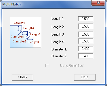

Multiple Notch
Click the Multiple Notch button in the Notching window to create a set of chamfered notches with relief holes. While you can specify a range of 0.001 to 1000000 for Length 1, Length 2, Length 3, Length 4, Diameter 1 and Diameter 2, there are some constraints that you must observe. As an alternative, you can specify a round tool to create the relief holes by placing a check mark in the Using Relief Tool check box. Move into the work area, click each line in succession and the system will apply the notches and trim the lines.
Length 1
Length 1 determines where the first notch begins the line, measured from the end point of the intersection.
Length 2
Length 2 determines the depth of the first notch.
Length 3
Length 3 determines the depth of the second notch.
Length 4
Length 4 determines where the second notch ends, measured from the end point of the intersection.
Diameter 1
Type a value to specify the diameter of the first relief hole. The value must be less than the minimum combined distances of Length 1 and Length 2:
Diameter 1 < Min (Length 1, Length 2)
Diameter 2
Type a value to specify the diameter of the second relief hole. The value must be less than the minimum combined distances of Length 3 and Length 4:
Diameter 2 < Min (Length 3, Length 4)
Using Relief Tool
Back / Close
Click the < Back button to return to the Notches window to select a different notch type. Click the Close button to exit the window.

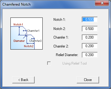

Chamfered Notch
Click the Chamfered Notch button in the Notching window to create relief notch with a set of chamfers. While you can specify a range of 0.001 to 1000000 for Notch 1, Notch 2, Chamfer 1, Chamfer 2 and Relief Diameter, there are constraints you must observe. As an alternative, you can specify a round tool to create the relief hole by placing a check mark in the Using Relief Tool check box. Move into the work area, click each line in succession and the system will apply the Chamfered Notch and trim the lines.
Notch 1
The height of the notch, measured from the horizontal line.
Notch 2
The width of the notch, measured from the vertical line.
Chamfer 1
The length of the first chamfer. The constraint is: Chamfer 1 < Notch 1.
Chamfer 2
The length of the second chamfer. The constraint is: Chamfer 2 < Notch 2.
Relief Diameter
Type a value to specify the diameter of the relief hole. The constraint is: Relief Diameter < Min(Notch 2-Chamfer 2, Notch 1*(Notch 2 - Chamfer 2)/(Notch 2-Chamfer 2+Chamfer 1).
Using Relief Tool
Back / Close

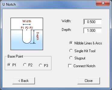

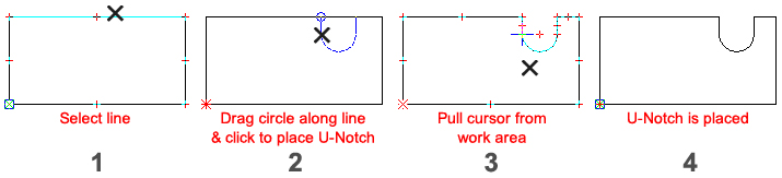

U-Notch
Click the U-Notch button in the Notching window to apply a U-Notch to a line. While you can specify a range of 0.001 to 1000000 for the Width and Depth, the Depth value must be greater than or equal to the Width value. The Base Point options, P1, P2 and P3, determine the relative starting position of the U-Notch relative to the end point of the selected line. The selected base point will appear as a small circle after you choose the line. Move into the work area, click a line and a  U-Notch indicator will appear. Select the position for the U-Notch and the system will apply the U-notch and trim the lines. The option will remain active until you cancel the operation.
Width
Type the actual size of the notch.
Depth
Type the depth of the notch. For U-Notches, the Depth is measured perpendicular from the selected line to the radius of the arc. The constraint is: Depth >= Width.
Base Point
Choose the relative starting position of the U-notch from the end point of the selected line.
P1
The start point will begin relative to the left of the end point of the selected line.
P2
The start point will be centered relative to the end point of the selected line.
P3
The start point will begin relative to the right of the end point of the selected line.
Nibble Lines & Arcs
Single Hit Tool
Slugout
Connect Notch
When Nibble Lines & Arcs is selected, the program will assign a nibble tool to the pattern.
When Single Hit Tool is selected, Connect Notch will be auto-checked ON and the program will assign a single Obround tool.
When Slugout is selected, Connect Notch will be auto-checked ON and the program will assign a Round tool and a Rectangle/Square tool to slugout.
When Connect Notch is checked ON, the notch will have a closed boundary.
Back / Close
Placing a U-Notch

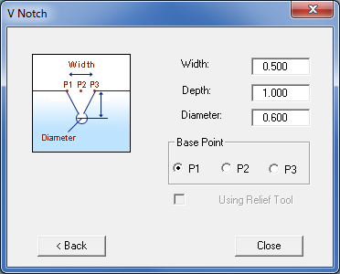

V-Notch
Click the V-Notch button in the Notching window to apply a V-Notch with a relief hole to a line. While you can specify a range of 0.001 to 1000000 for the Width and Depth, there is a constraint for the Diameter. As an alternative, you can specify a round tool to create the relief hole by placing a check mark in the Using Relief Tool check box. The Base Point options, P1, P2 and P3, determine the relative starting position of the V-Notch relative to the end point of the selected line. The selected base point will appear as a small circle after you choose the line. Move into the work area, click a line and the V-Notch indicator will appear. Select the position for the V-Notch and the system will apply the V-Notch and trim the lines. The option will remain active until you cancel the operation.
When assigning, a V-Notch will snap to snap points. After snapping to snap point, left-click to move the notch. Left-click again to finalize the position and allow the notch to be resized by dragging it.
Width
Depth
Type the depth of the notch. For a V-notch, the Depth is measured perpendicular from the selected line to the center point of the relief hole.
Diameter
Diameter < SQRT(Square(Width)+Square(Depth))
Base Point
Choose the relative starting position of the V-notch from the end point of the selected line.
P1
P2
P3
Using Relief Tool
Back / Close
See Placing a U-Notch for a basic example.

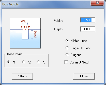

Box Notch
Click the Box Notch button in the Notching window to apply a box or channel notch to a line. While you can specify a range of 0.001 to 1000000 for the Width and Depth, the Depth value must be greater than or equal to the Width value. The Base Point options, P1, P2 and P3, determine the relative starting position of the box notch relative to the end point of the selected line. The selected base point will appear as a small circle after you choose the line. Move into the work area, click a line and the Box Notch indicator will appear. Select the position for the box notch and the system will apply the box notch and trim the lines. The option will remain active until you cancel the operation.
Width
Depth
Type the depth of the notch. For channel notches, the Depth is measured perpendicular from the selected line to the radius of the arc. The constraint is: Depth >= Width.
Base Point
P1
P2
P3
Nibble Lines & Arcs
Single Hit Tool
Slugout
Connect Notch
When Single Hit Tool is selected, Connect Notch will be auto-checked ON and the program will assign a single Rectangle tool.
When Slugout is selected, Connect Notch will be auto-checked ON and the program will assign a Rectangle/Square tool to slugout.
Back / Close

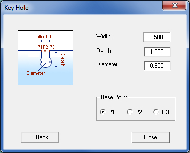

Key Hole
Click the Key Hole button in the Notching window to apply a keyhole notch to a line. While you can specify a range of 0.001 to 1000000 for the Width and Depth, the Depth value must be greater than the Width value. The Base Point options, P1, P2 and P3, determine the relative starting position of the key hole relative to the end point of the selected line. The selected base point will appear as a small circle after you choose the line. Move into the work area, click a line and the Key Hole indicator will appear. Select the position for the key hole and the system will apply the key hole and trim the lines. The option will remain active until you cancel the operation.
Width
Depth
Type the depth of the notch. For key hole notches, the Depth is measured perpendicular from the selected line to the radius of the hole. The constraint is: Depth > Width.
Diameter
Type a value to specify the diameter of the hole. The constraint is:
Base Point
Choose the relative starting position of the key hole from the end point of the selected line.
P1
P2
P3
Back / Close
