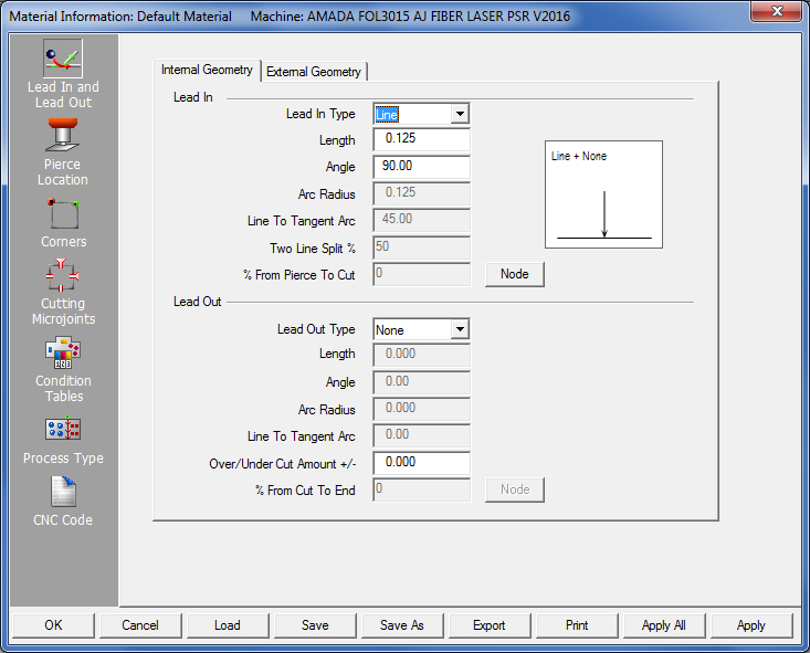

The Lead In/Lead Out panel allows the user to specify the lead-in and lead-out parameters for your materials. On this page learn about using the options on the Internal Geometry (Lead In) and External Geometry (Lead Out) tabs to define the lengths, angles and cutting conditions.
Internal Geometry and External Geometry
The lead-in/lead-out parameters defined for internal geometry are applied to the inside perimeters of the patterns, while those defined for external geometry are applied to the outside boundary of the parts.

As the lead-ins and lead-outs are defined, the thumbnail graphic in the Display box updates to reflect any changes made to the values. The image here shows that a "Line & Arc" Lead In was selected. The "+ None" indicates that no Lead Out has been selected.
Lead In Types
There are six lead-in types: Line, Two Lines, Line and Arc, Hook, Cross Cut and None. The lead-in selected is used as the default for all the geometry on the part. Choose an alternate lead-in type by selecting the appropriate option button.

Line - Lead In
The Line Lead In is the default selection. It consists of a straight line that can be set to any angle. For a Line Lead In, only the Length, Angle and Node options are available. The illustrations below depict the variables that can be specified for the Line Lead In.
The Start Point is derived from the Length and Angle relative to the geometry. The Length is the distance from the geometry to the Start Point of the Lead In. The Angle is a value, expressed in degrees that the Lead In will be from the geometry. The cutting direction determines where the Angle begins from the geometry to the Start Point. The Angle is consistent relative to the position of the geometry.
The Node location is expressed as a percentage from the Pierce point down towards the geometry. The illustrations depict Lead Ins at different positions using a Length of 0.250 at an Angle of 35º. Notice the different cutting directions. The angle shifts, but remains the same angle. The Lead In moves in the same direction as the cut.
