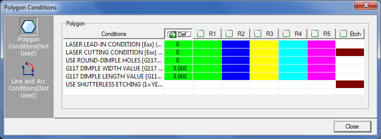

Applying Range Values to Attributes
If you double-click the Range label or click the Range navigation button in the Start Cut Attribute or Group Edit Attribute window, the Polygon Conditions window will appear. The window is divided into two panels: Polygon Conditions and Line and Arc Conditions. The options in the window allow you to apply the conditions you defined for polygons, lines and arcs in the material file to the features that comprise the Start Cut Attributes or Group Attributes.
Applying Standard Range Values
The Standard Shapes Conditions will appear if you are modifying the attributes of a standard shape. The Conditions column lists all the values supported by the machine driver. The Default column lists all the conditions you defined in the Default Conditions table of the Condition Tables panel. Columns R1 through R5 list the range settings you defined for Polygon Conditions. The Etch column lists the values you defined for Etching.
A Range button with an arrow indicates the system will use those values to process the Start Cut Attributes or Group Attributes. Click the button in the column header to assign the values of a particular range to the Start Cut Attributes. Click the Close button to exit the window. When you return to the Start Cut Attribute or Group Edit Attribute window, the selected range appears in the Range field and the conditions will be applied to the selected geometry.
Applying Polygon Ranges
The Polygon Conditions window will appear if you are modifying the Start Cut attributes of a polygon. The window is divided into two panels: Polygon Conditions and Line and Arc Conditions. The Polygon Conditions panel is active by default.
The options in the window allow you to apply the conditions you defined for polygons, lines and arcs in the material file to the features that comprise the Start Cut Attributes or Group Attributes. The Conditions column lists all the values supported by the machine driver. The Default column lists all the conditions you defined in the Default Conditions table of the Condition Tables panel. Columns R1 through R5 list the range settings you defined for Polygon Conditions. The Etch column lists the values you defined for Etching.
A Range button with an arrow indicates the system will use those values to process the Start Cut Attributes or Group Attributes. Click the button in the column header to assign the values of a particular range to the Start Cut Attributes. Click Close to exit the window. When you return to the Start Cut Attribute or Group Edit Attribute window, the selected range appears in the Range field and the conditions will be applied to the selected geometry.
Applying Line and Arc Ranges
Click the Line and Arc Conditions button in the navigation bar to access the range values you defined for lines and arcs. The Lines section displays all the values you defined for Line Conditions; the Arcs section displays all the values you defined for Arc Conditions. The Conditions columns list all the values supported by the machine driver. The corresponding Default, R1 through R5, and Etch columns list all the conditions you defined for Default Conditions, Line Conditions and Arc Conditions respectively.
A Range button with an arrow indicates the system will use those values to process the Start Cut Attributes or Group Attributes. Click the button in the column header to assign the values of a line or arc range to the Start Cut Attributes. Click Close to exit the window. When you return to the Start Cut Attribute or Group Edit Attribute window, the selected range appears in the Range field and the conditions will be applied to the selected geometry.
