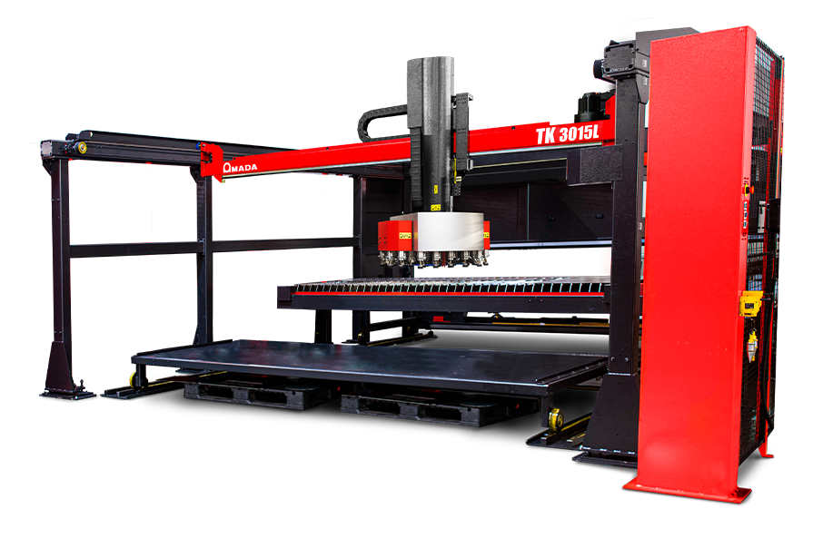

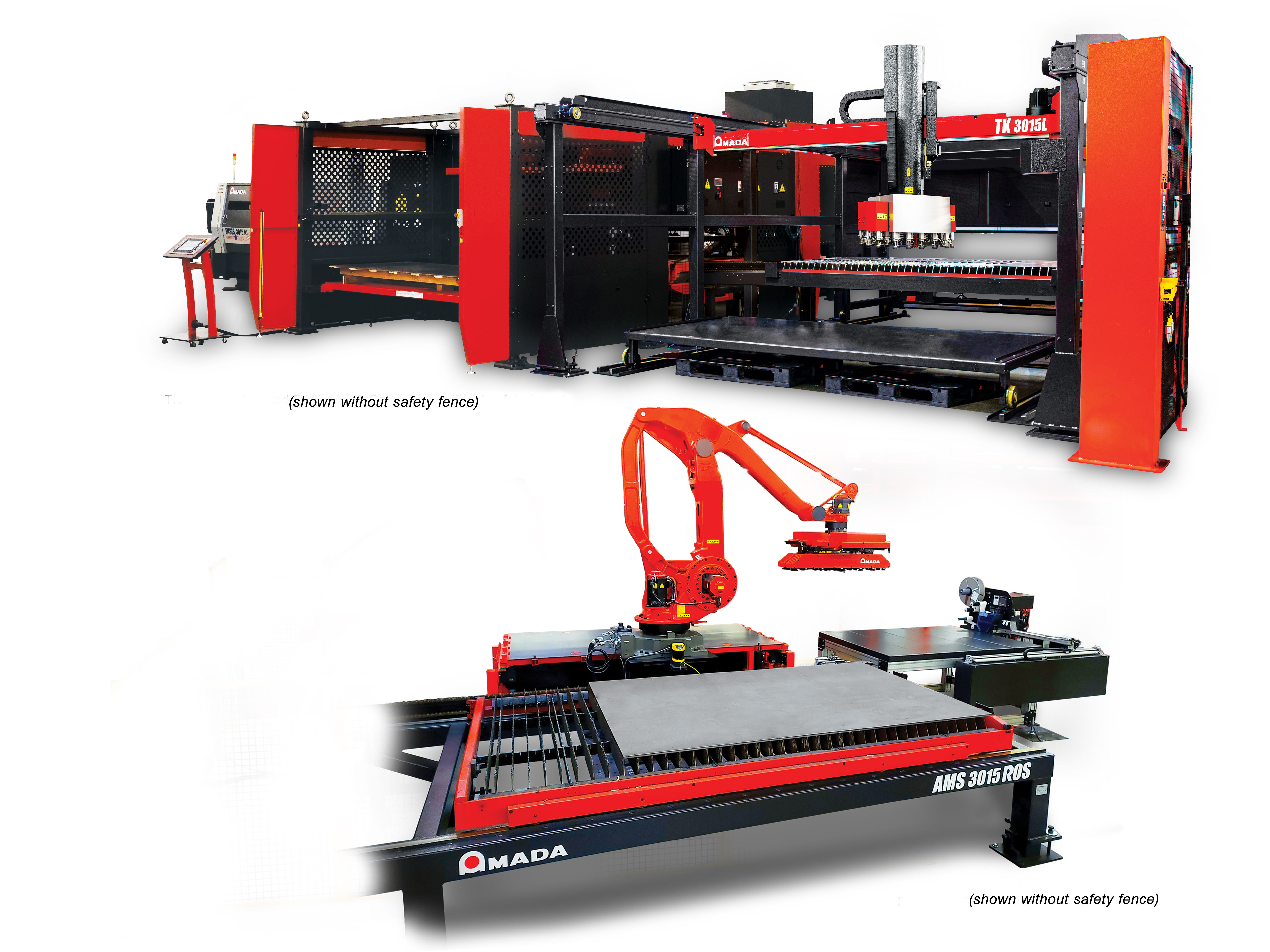

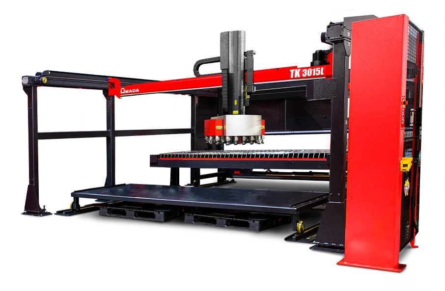

The TK-L Automated Parts Sorting Cell from AMADA simplifies and accelerates your post-laser workflow. Whether handling delicate part nests or large panels, its gantry-style cell will pick and place parts with precision—eliminating tedious, manual sorting. With intelligent stacking logic, it organizes parts by their next production phase, reducing downstream mistakes and labor. Backed by AMADA’s powerful VPSS 4ie Blank software, the TK-L allows you to program smarter, run longer, and hand off parts seamlessly to the next stage.
  • Gantry-style automated part removal boosts efficiency and throughput, allowing the laser to run longer without operator intervention.
  • Improves accuracy of stacked parts by sorting according to their next production phase to reduce downstream errors.
  • Reduced manual labor frees operators for higher-value tasks.
  • Flexible design allows system to deal with very intricate part nests or large panels.
  • Customizable Vacuum System uses individual vacuum cups. System can be customized (magnet pick-up options for certain shapes) according to part types.
  • Integrated with AMADA’s VPSS 4ie Blank software, where part-removal strategies can be defined ahead of time.
  • TK settings in VPSS 4ie Blank now allow configuring part unloading to a conveyor belt (for integration with downstream automation).
  • Maximum Pick up weight: 150 kg (330 lbs.)
  • Maximum part size: 2500 mm x 1250 mm (8' x 4')
  • Minimum part size: 250 mm x 50 mm (9" x 2")
  • Maximum stack height: 260 mm (10.25")
  • Suction configuration: 81 individual suction cups.

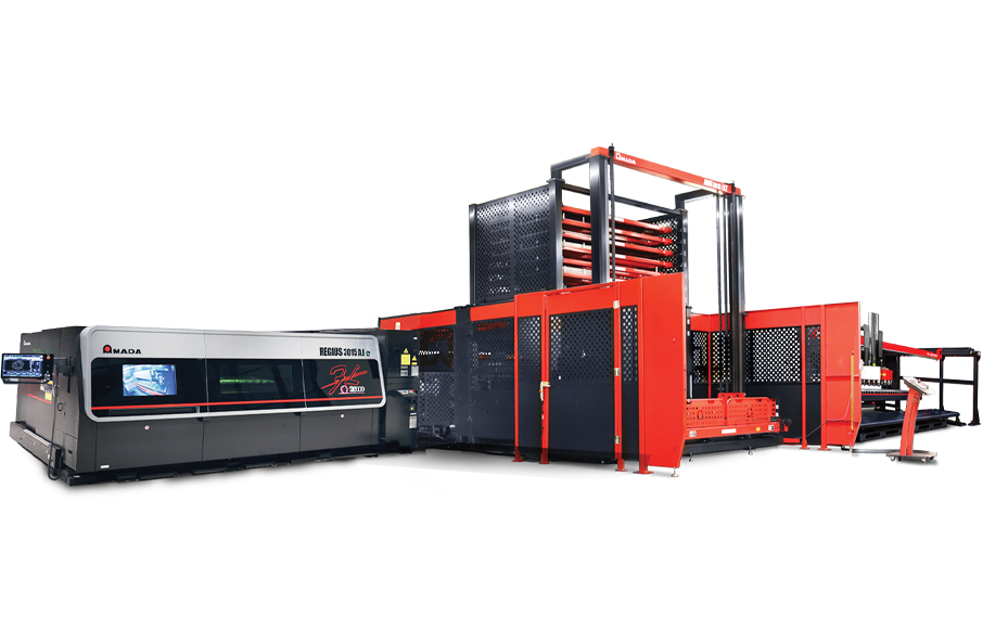

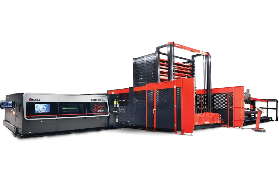

AMS CL REGIUS 3015 Fiber Laser with
AMS CLT and TK-L
