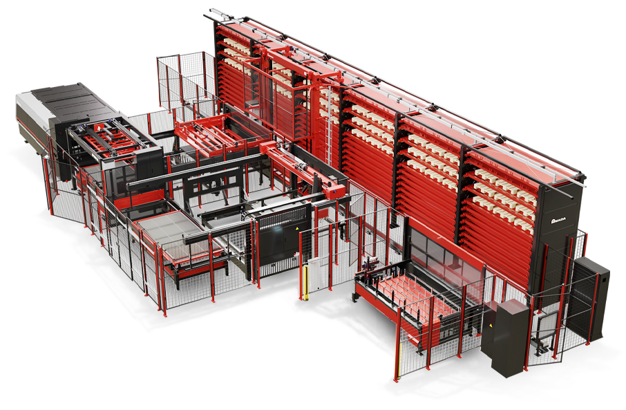

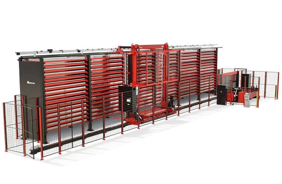

configurable high-density automated material storage tower

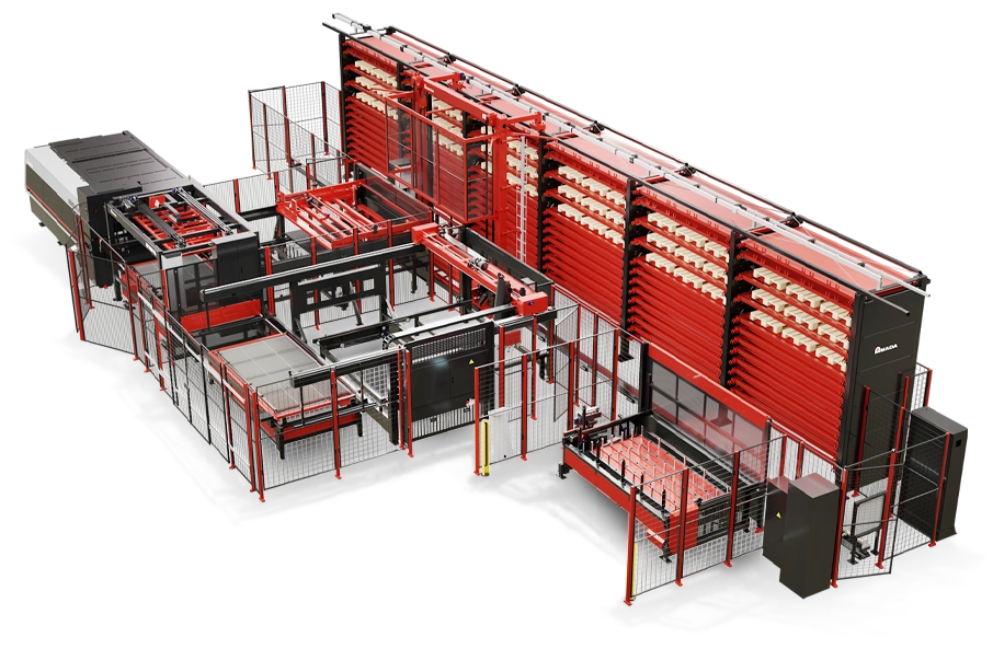

The CS II 300 from AMADA is a powerful, compact storage system that centralizes your raw material and part inventory while minimizing manual handling. Designed for integration with punch, laser, and bending cells, the modular CS II 300 supports automated pallet management using a stacker crane— letting your production run with minimal interruptions. Whether you’re aiming to boost throughput, enable 24/7 production, or scale your cell-by-cell automation, CS II 300 delivers flexibility and efficiency.
  • Fully automated pallet management and movement based on production schedules—no manual pallet handling needed during operations.
  • Modular concept lets you configure the number of “sections” /storage zones depending on how many pallets and what types (raw, parts, skeleton) you need.
  • Scalable storage capacity is customizable, ranging from 30 to 999 pallets, and the system can be expanded from single row to double row layouts.
  • Designed to minimize footprint via vertical storage; stack heights can be tailored to material types and shop layout.
  • MultiType material buffer supports storage for raw material, finished parts, and skeleton/micro-joint sheets—ideal for integrated production cells.
  • Flexible machine connectivity can connect to various AMADA machines, including L III loaders, PR III unloaders, R3015 TK, MP Flexit, and more.

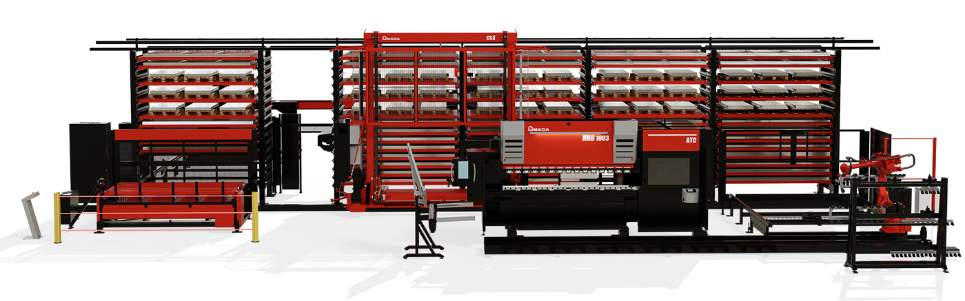

MARS Modular Automated Retrieval and Storage
  • Integrated control uses a stacker crane to move pallets between storage, I/O stations, and connected machining cells; managed via AMADA’s FMS controller.

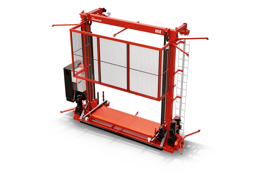

  • Stacker crane speeds without load: X-axis 2,500 mm/s, Y-axis 500 mm/s, Z-axis 440 mm/s. With load: X-axis 2,000 mm/s, Y-axis 300 mm/s, Z-axis 350 mm/s.
  • Maximum load per pallet: Up to 3,000 kg. (6,610 lbs.)
  • Supported sheet size:
    CS II 300: up to 3,050 x 1,525 mm.
    CS II 300/40 variant: up to 4,070 x 1,525 mm.
    Uses AMADA FMS controller (ISC) for both storage control and cell scheduling.
  • Easily expandable: Designed for future growth, with the ability to add storage capacity and core machines as production demands increase.

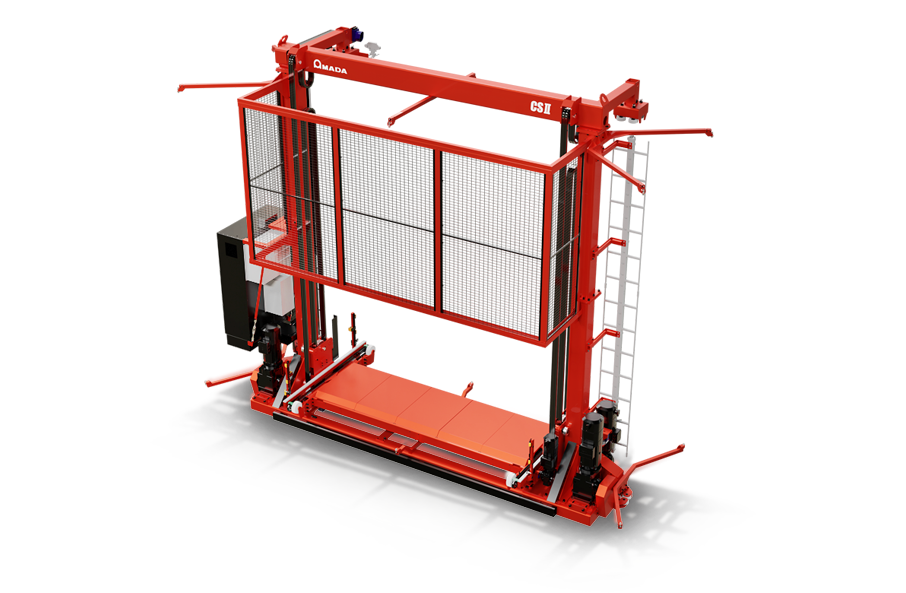

STACKER CRANE AND RAIL
The stacker crane automatically transfers the pallets between the storage and stations or production cells. The stacker crane features a weight control unit that can automatically count the number of sheets present on a pallet by cross-referencing the measured weight with the material data registered in the software. The weight control unit is a time-saving feature that eliminates the need for manual calculation and the risk of human error. The weight control unit is especially useful for easy inventory management by simplifying the task of keeping track of stock differences.

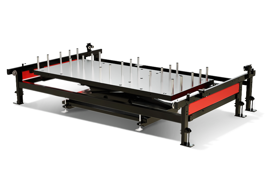

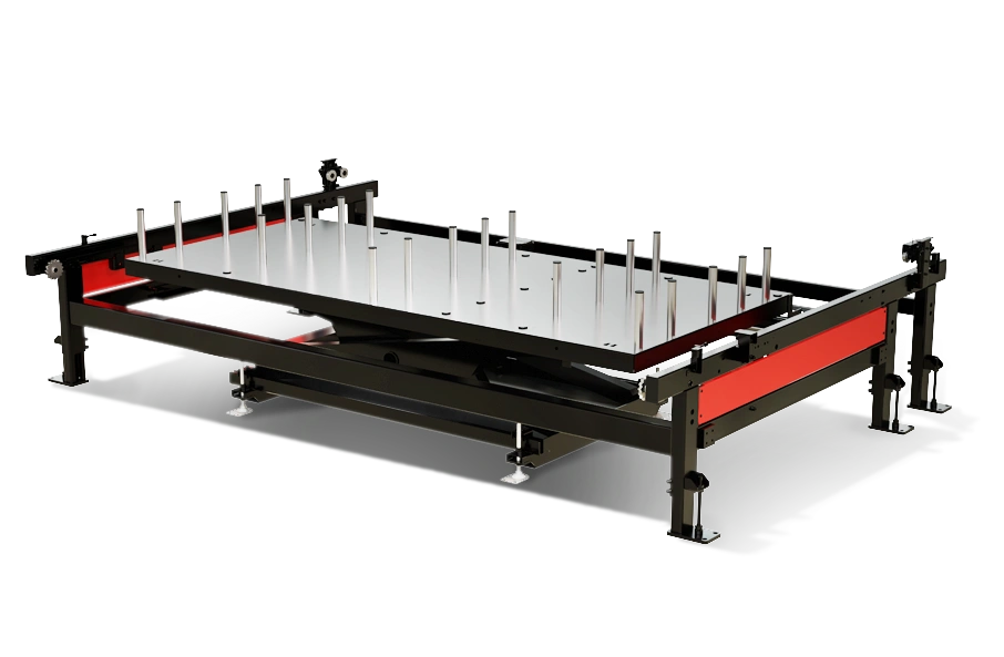

INPUT/OUTPUT STATION
The input-output station of the CSII is the single point of access for loading new material into the system, as well as removing parts for the next production step or emptying the skeleton trays after the night shift. The I/O station is designed with efficiency and usability in mind and features automatic positioning of the sheet stack when loading new material onto a CS pallet—ensuring perfect alignment every time, while significantly reducing the time spent compared to manual positioning.
Input Output Station

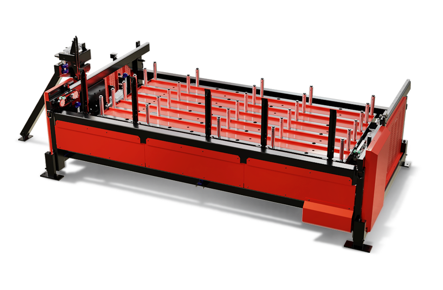

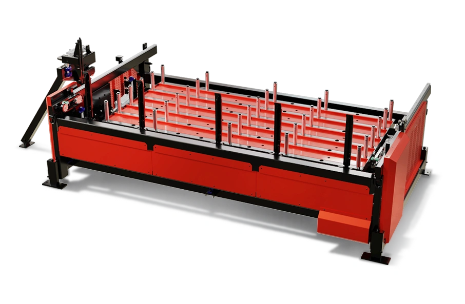

OUTPUT STATION Optional
One or several output stations can be added to the CS system to add flexibility or streamline the production flow. The output station provides simple access point for unloading parts. If the station is equipped with the optional pin table, this enables the user to remove base plates with micro-jointed material or scrap so that these can be processed at a designated area.
Output Station Optional
