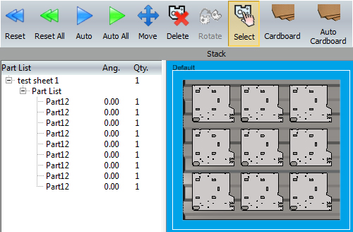

Step 2
After the Stacking module opened with the parts on the stacking table as shown in the above image, the user must hit Reset and then Auto. This results in a layer of nine parts on the pallet/table shown in this image. There isn't any space for the remaining nine parts (Part12) so they have remained in the Part List. They can be manually stacked later. To have parts stacked in one layer, the Stack Parts checkbox must be switched OFF. Click for info on creating and configuring Stack table layout and Pallet type and layout.
Step 3
When the Cardboard icon is selected, all parts on the pallet will be hidden, but can be found listed in the Part list (replacing the "Part12" parts shown in Step 2). In order to insert cardboard between the pallet and the first layer of parts, right-click the first part in the list and then select Insert Cardboard. The sheet of cardboard will then display under the first part that shows on the pallet as shown here -
Step 4
To have all parts for that layer display on the pallet with cardboard, the user must click each part individually or simply click the last part as shown here. This layer is now complete. To remove a sheet of cardboard right-click Cardboard in the list and click Delete.
