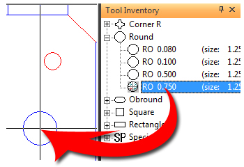

Once the correct tool inventory is loaded, select Place Tool Hits. The Tool Inventory window appears. The Tool Inventory window will list only those tools that will fit into the turret stations. The tools are listed in alphabetical order, with the special tools listed at the end. Navigate through the hierarchical list and click the tool name to select it. Note: To precisely position patterns try the Coordinates feature in the Draw menu.

Tools may be dragged from the
inventory onto patterns in the part
