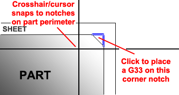

If the laser head encounters part corner notches on the sheet that may have fallen out beforehand, the sensor detects the hole, and the head drops down in an effort to maintain distance from the material, thus causing a collision.
Note: Process Parts/Grids in the Common Cutting sub-menu first to enable the option. Also, check ON Straight Edge Cut in Common Cutting Settings.
The user must select the Manual Trace off option and then click on parts on the sheet that have corner notches and may possibly have this problem.
The system still continues to cut out part perimeters using a standard G32 (Manual Trace ON), allowing the laser head to sense the surface of the sheet. However, when the laser head approaches a corner notch with a G33 (Manual Trace OFF), the head will ignore the hole in the sheet. After the laser head passes the corner, the G32 will kick in again and the part perimeter will be cut out.
Enabling Manual Trace off for certain corner notches on parts on a sheet inserts a G33 in the NC code, that will allow the laser head to ignore the hole and continue lasing, thus avoiding a possible collision.
