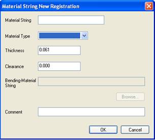

| Click Yes and a dialog box is displayed allowing you to create a New Material for the SDD Database. If you want to create a new material enter the required information and select OK.
| If you want to choose an existing material, select Cancel and the Material String List containing existing materials will be displayed:
