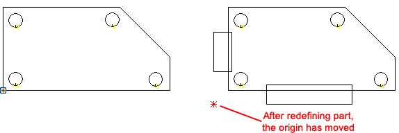

Redefine Part
To modify the part size if patterns are added that extend beyond the original part boundaries, use the Redefine Part option to recalculate the size.
After patterns were added to the part and the user selected the Redefine option, the origin has moved to accommodate the larger size.
