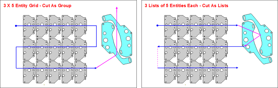

Cut entire grid of entities as a rectangular group, rather than as multiple lists: A group of parts with the same geometry can be packed (or grouped) to be cut as a single entity. The image at left shows the cutting result with this option checked ON. The smaller gray parts are cut first, then the larger aqua parts are cut.
If the option is NOT selected, the smaller and larger parts will be cut in a normally sequenced row as shown in the image at right.

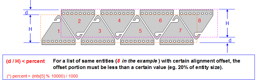

Max. Grid List Offset (%): Enter a value for the percentage of the offset portion (d), which is a percentage of the part size (H). For example, if a value of 20% is entered, the width of the offset portion of the part must be less than 20% of the part size in H. This will combine the parts as a single list and be cut accordingly. However, if d over H is greater than 20%, the parts will be separated into two lists.
