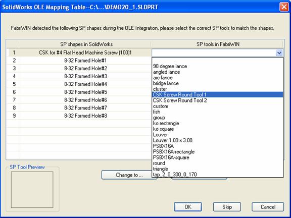

Map SolidWorks®  Forming Feature With the Special Tool(s) of AP100US
When using the command Open&OLE or OLE Integration, the system provides a method to enable the user to map the forming shape of SolidWorks® with the SP tools in AP100US. When a Form Shape is detected on the Face of the 3D model, then the item will come over to a Group within AP100US, which can easily be assigned a tool.
