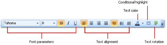

To change the "Text" object appearance, use the "Text" toolbar:

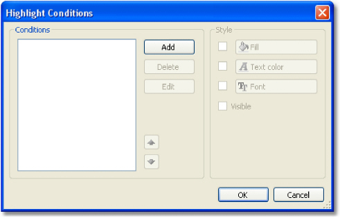

There
is an possibility to change the "Text" object's appearance depending
on the given conditions. For example, an object can be highlighted
with red color if it has a negative value. This feature is called
"conditional highlighting". To set up it, select the "Text"
object and click button
on the "Text" toolbar.You will see the following dialog window:
It is possible to define one or several conditions and set up the style for every condition. Style can contain one or several settings:
fill;
text color;
font;
object's visibility.
You can indicate, which settings need to be changed when the condition is met. For this, check the needed setting using the checkbox. By default, a new style contains one setting -the text color.
In order to create a new condition, click the "Add" button. You will see an expression editor:
Here, it is possible to write any expression which returns a boolean result. In many cases you will use the "Value" variable, which contains the currently printing value.
Let us look at the following example: we have a "Text" object, in which we print the amount of products in stock:
[Products.UnitsInStock]
We want to paint the object red, if the amount of products = 0. For this, we create the following condition:
Value == 0
In the given case, we used the "Value" variable, which has got a printed value. If there are several expressions in an object, then this variable will have the value of the last expression. Instead of "Value", you can use a data column:
[Products.UnitsInStock] == 0
The expression is written in C# style. This is so, if the chosen report language is C#. For VisualBasic.Net you must use the single "=" sign. The report language can be changed in the "Report|Options..." menu.
Configure the style for the given condition in such a way that only fill can be used, and choose the red color:
When printing an object which has a zero value, it will be red. Let us make our example more complex, we will add another condition. If the units in stock is less than 10, it must be printed yellow. To do this, open the condition editor and click the "Add" button. The second condition will be like this:
Value < 10
In case where several conditions have been indicated, FastReport checks all the conditions, starting from the first one. If a certain condition is met, FastReport applies its style settings to the object, and the process stops. It is important to put the conditions in a correct order. The order which we have seen in this example is correct:
Value == 0
Value < 10
If we swap conditions, then the highlighting will work wrongly.
Value < 10
Value == 0
In the given case, the "Value==0" will not be executed, because when the value is zero, then

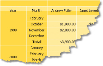

In order to improve the appearance of a report, you can highlight even data rows in different colors. This can be done by using the "EvenStyle" property of the band or its objects. The property contains a style name, which will be used to highlight even band rows.
It is preferable to use the "EvenStyle" property of the object instead of the band. This avoids possible problems when exporting the report.
In order to configure the highlighting, do the following:
1.Define the style, which will be used for highlighting the rows. This can be done in the
"Report|Styles..." menu.
2.Indicate the name of the new style in the "EvenStyle" property of the band or its objects.
By default, objects use only a fill property of the style given in the "EvenStyle" property. This behavior is defined in the "EvenStylePriority" property - by default it is "UseFill". If you need to use the rest of the style parameters, set this property to "UseAll".
A ready report, which uses this technique, can look like this:

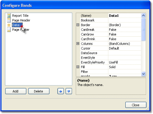

In order to add a detail data band, call the "Configure Bands" window. This can be done by pressing the "Configure bands..." button, shown in the figure, or by choosing the "Report| Configure Bands..." menu item. In the configurations window, the band structure is displayed:
Select the "Data" band, as shown in the figure, and right click the mouse in order to show the context menu (or press the "Add" button in the lower part of the window). In the window which will open, select "Data" band:
After this, a nested "Data" is added to the selected band. Close the window by pressing the "Close" button. You will see that the report template changes in the following way:
Nested data bands are clearly seen on band structures on the left part of the window. After this, you need to connect the band to the corresponding data source and place data columns on the bands. We will be using two data sources - Categories and Products - from the demo data base which comes with FastReport:

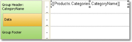

A group is a set of three bands: "Group header", "Data" and "Group footer". In designer, this looks as follows:
A group always contains a header and data. Group footer is optional, you can delete it.
In order to use a group, you should set the group condition for the group header, and connect the data source to the "Data" band. The condition can be any expression, but as a rule, this is one of the data source columns. Group printing is done in the following way:
1.group header is printed.
2.data row is printed.
3.checks if the grouping condition has changed.
4.if the condition has not changed, next data row is printed (p.2).
5.if the condition has changed, the group footer is printed, and starts printing a new group
(p.1).
Assuming that we have a Products table with the following data:
Data can be grouped on the CategoryName column. This column will be printed in the group header. The data itself is presented by the ProductName field. The report will be as follows:
If we run the report, the following will be seen:
Adding a group into a report can be done by using two methods.
First method: you add the "Group header" band in the "Configure Bands" window. To do this, press the "Add" button and select the "Group header" band. FastReport adds the group to the available "Data" band or will create a whole group, if such a band is not in the report:
In order to configure a group, double click the "Group header" band. You will see the group header editor window:
You need to set the group condition. This can be any expression or data source column. Also choose the sorting. By default, data is sorted in ascending order.
Second method: you use the wizard, which can be called from the "Report|Group Expert..." menu. In order to create a group, enter the group condition and press the "Add" button:
The wizard will add all the elements of the group into the report. Also it creates the "Text" object on the group header, in which the group condition is printed:

A nested group has several "Group header" bands. The last band contains the "Data" band:
Every group header has its own group condition.
Creating a nested group can be done in the same way like an ordinary. In the first case, you create a simple group and add the nested group in the "Configure Bands" window. For this, select the existing "Group header" band, press the "Add" button and add another "Group header" band:
After this, call the editor of the added group and set up the group condition.
In the second case, you use the group expert which we have looked at already. Set the grouping condition and click the "Add" button. The wizard will add the new group to the existing one.

The matrix will have one value in a row, two values in a column and one data cell. We will get the previous example as a base and add a new item into it:
we will add the "Month" data column to the row header to the right of "Year" item.
After adding a new item, improve the appearance of the matrix. It is also necessary to set up formatting for cells. After that, the matrix will be as follows:
Run the report and you will have the following result:

Example 4. Conditional highlighting
You can set conditional highlighting for matrix cells, just like for "Text" object. More details about this can be found in the "Conditional highlighting" section.
Let us look at Example 2, and see how to highlight an amount more than 3000 in red. For this,
select
the cell with "Revenue" text and press the button
on "Text" toolbar. In the conditions editor, add the following
condition:
Value > 3000
Choose red text color for the condition. A prepared report will be as follows:

Call the conditional highlighting editor. Add the following condition:
Matrix1.RowIndex % 2 != 0
and choose background color a little darker than the previous one. In this example "Matrix1" is a name of our matrix. The "RowIndex" property of the matrix returns the number of the current printed line.
For column highlighting, use the matrix "ColumnIndex" property in the same way.

In previous examples we created matrix by dragging columns from the "Data" window. You can also use expressions for this purpose. In order to insert an expression into a matrix do the following:
add any element from "Data" window into matrix. It can be any element, for example, a system variable "Date" - we just use it to create a matrix element;
double click the element and select the needed expression in the expressions editor window.
If your matrix has expressions instead of data field, you have to check that the matrix "DataSource" property was set up correctly. When working with data columns, this property is filled automatically when you drag a column onto a matrix.
Let us consider an example on how to use expressions. For this, we will use the "Order Details" table as a data source, which contains a list of sold products, grouped by employees. There are several relations in this table, which gives an access to the name of an employee, product name and its category.
Our matrix will show each employee's sales, categorized by products. In order to build the matrix, do the following:
add the "Order Details.Products.Categories.CategoryName" data column to the column header;
add any item to the row header in order to create a matrix element. Then set the following expression for the header element:
[Order Details.Orders.Employees.FirstName] + " " + [Order Details.Orders.Employees. LastName]
add any item to data cell in order to create a matrix element. Then set the following expression for the cell:
[Order Details.UnitPrice] * [Order Details.Quantity] * (decimal)(1 - [Order Details.Discount])
Why
did we indicate such a long data column as a name of an employee though
we could get a name from the "Employees.FirstName"? We
did that because the matrix is connected to "Order Details"
data source. Using relations between this data source and other tables,
it is easy to refer to its columns (more details about relations
can be read in the "Data" chapter). If we refer directly
to the "Employees.FirstName" data column, we will get a name
of the first
employee in a table.
Set up the matrix appearance. After that it will look as the follows:
When we run the report, we will see quite a big matrix which occupies 2 sheets:

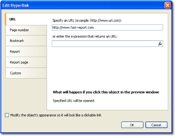

To configure a hyperlink, select the object which you want to make interactive, and right click on it. In the context menu, select the "Hyperlink..." item. The hyperlink editor window will open:
Choose the type of hyperlink by selecting the tab in the left side of the window. After you have done, you may click the "Modify the object's appearance..." checkbox at the bottom of the window. The appearance of the object will change in the following way:
blue color will be set for the text and it will underlined;
a hand cursor form will be set.
In some cases hyperlink needs to be shown in the preview window, but there is no need to print it. This is easy to do, if you disable the "Printable" object property. This can be done in the "Properties" window.
Using this type of link, you can:
navigate to the given internet address;
execute some kind of system commands, for example, "mailto:" for sending an email.
When clicking on the link of this type, the System.Diagnostics.Process.Start method is executed with the link's value as a parameter.
You can indicate the value of the link by using two methods:
indicate the value directly, for example, "http://www.fast-report.com";
indicate an expression, which returns the value of the link. This expression will be calculated when you run the report.

In this example, we will create a simple report with one "Text" object. When clicking on the object in the preview window we will move to the FastReport web-page.
Create a new report, and add the "Text" object. Write the following text into it:
Go FastReport home page
Right click on the object and select the "Hyperlink..." item in the context menu. Configure the link in the following way:
After this, enable the "Modify the object's appearance..." checkbox, in order to apply some link attributes (blue text color, underlining and a hand-like cursor) to the object.
Run the report and click on the object. The web-browser window opens, and you will move to the FastReport home page.

Configure the matrix in the following way:
put the "MatrixDemo.Year" data column in the column header;
put the "MatrixDemo.Name" data column in the row header;
put the "MatrixDemo.Revenue" data column in the cell.
A prepared matrix will be as follows:
As seen, the value of a cell is the sum of employee's sales for the whole year. Let us create a detailed report which will be displayed when we click the cell. In our case the detailed report can contain the sales of a selected employee for every month of a selected year.
How to connect a cell with data, on which basis it was printed? Each cell of the matrix has got its own address. This is a combination of the values from the column and row headers. In our example, the address of the cell is a combination of the year and name of the employee. Exactly this data can be passed to the detailed report. How can this be done? Very simple: set the hyperlink, showing only the report name and name of the parameter. Parameter values do not need to be indicated: for a matrix cell, FastReport itself forms the value and passes it into the parameter.
Assuming that, we have clicked on the top left cell, containing the number 3900. This is the sum of the sales of the employee named "Andrew Fuller" for the year 1999. What form is used to pass this value into the parameter? FastReport combines column and row values, by using a separator:

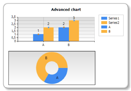

FastReport uses Microsoft Chart library to display charts. This library will be included in .Net Framework 4.0. Now it is available as a separate download here:
http://www.microsoft.com/downloads/details.aspx?FamilyID=130f7986-bf49-4fe5-9ca8-910ae6ea442c
This library requires .Net Framework 3.5 SP1. It is freeware; you can learn about its features here:
http://code.msdn.microsoft.com/mschart
Let us highlight some features of Microsoft Chart:
more than 30 types of series (bars, columns, areas, lines, bubbles, pie, circular, financial, pyramidal, ranges);
3D support;
supports several series of different types in one chart;
full control over appearance and behavior of each chart element.
Microsoft Chart consists of the following elements:
One chart may have one or several chart areas. One chart area may contain one or several series. Below you can see the chart which contains two chart areas (the first area contains two series, the second area contains one series):
Some series (for example, pie series) require exclusive chart area.
The "Chart" object contains numerous settings which can be handled in the chart editor. To invoke the editor, double click the "Chart" object:
The "Chart" object can contain one or several series. Series list is displayed in the editor:
To add a new series, press the "Add..." button. You will see the "Gallery" dialog:
Select the needed category, then - needed series type. If you want to place the series in its own chart area, check the "Add new chart area for this series" checkbox. For some series types (such as pie, circular, financial, pyramidal) the new chart area is added automatically regardless of this checkbox state.
To delete the series, press the "Delete" button. To change series order, use "Up" and "Down" buttons.
Using the chart editor, you can set up appearance of each chart element. All properties (more than 100) are splitted in several categories. Some of them are specific to "Chart" object, while others are part of series.
If you choose the "Chart" object from the series list, you will see the following property pages:

Now set up the hyperlink of the "Chart" object:
in the context menu of the "Chart" object, select "Hyperlink...";
choose the hyperlink type - "Report page";
choose the second report page and indicate the parameter name - SelectedEmployee.

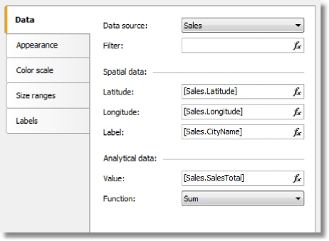

- for map layer type "geodata from an application" the "Data" tab looks like:
And the data required is:
- spatial data : latitude and longitude;
- label (eg: a city name);
- numeric value (eg: sales volume in this city).
For example, a "Sales" data source may have this data: Latitude Longitude CityName SalesTotal
48.13641 11.57753 München 50000
50.94165 6.95505 Köln 36000
Set up the "Data" tab in the following way:
- the data source: Sales
- spatial data, latitude: [Sales.Latitude]
- spatial data, longitude: [Sales.Longitude]
- spatial data, label: [Sales.CityName]
- analytical data, value: [Sales.SalesTotal]
- analytical data, function: "Sum"; this function is used if you have several values per city.
