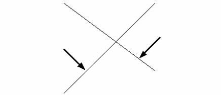

The Trim/Extend command can extend one line to another line, or shorten one line to stop at an intersection.
1.       When trimming lines, click the end of the line that you want to keep. This trims the correct end of the line. When prompted, click the line where you want to stop the first line. The first line redraws and stops at the second line you selected.
2.       If you want to trim/extend both lines, repeat the procedure and select the second line first.

Example 2 Trim Lines
Create a new 10 x 10 part. Draw two lines: Line 1 at 2X 3Y (Start Point X and Y), 6X 7Y (End Point X and Y) and Line 2 at 6X 4Y (Start Point X and Y), 2X 7Y (End Point X and Y).
Select Edit > Trim/Extend. You want to trim Line 1 to Line 2. Locate the first line (Line 1) and click it. When prompted, locate the second line (Line 2) and click it. The system will redraw the first line and trim it to the second line or a projected intersection point.
Line 2: 6X 4Y, 2X 7Y
Line 1: 2X 3Y, 6X 7Y
You want to keep this segment, so click Line 1 here.
Then click Line 2.
Line 1 trimmed to Line 2.
