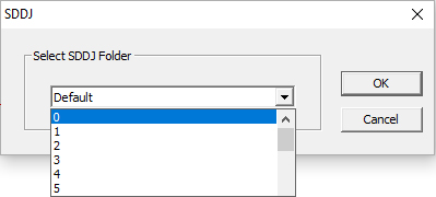

SDD NC Upload
This option allows the user to select an NC program and upload it to the SDDJ server directly. The NC program must have a corresponding JSON file in the same directory; that is, it must be generated by the SDD NC Export command.
With this feature Save and / or Upload generated NC Code to the SDD, without having to go through the entire process. In other words open a sheet and SDD NC Upload will allow the generated code be simply added to the SDD database. Select a file in the NC files folder and hit Open. In the dialog that opens (shown below) select an upload directory.
