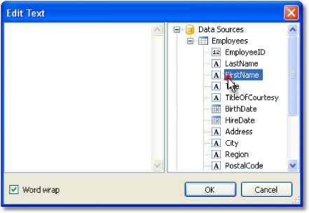

The "Text" object is the main object which you will use often. It looks like this:
The object can display any text data, specifically:
one or several text lines;
data columns;
report parameters;

There are several ways to insert a data column into the "Text" object.
In the "Text" object's editor we write the name of the data column manually. This method is the most inconvenient as it is easy to make a mistake.
In the object's editor we choose the needed data column and drag&drop it into the text:

This object can display each character of a text in its individual cell. It is often used to print some forms in financial applications.
The object is as follows:
In fact, this object is directly inherited from the "Text" object. You may connect it to data in the same manner. For example, you may invoke the object's editor and type the following text:
[Employees.FirstName]
The "Cellular Text" object has the following properties:
