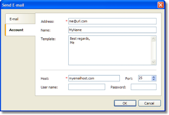

Send the report by email. |

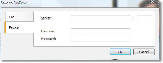

The "Save to SkyDrive" window has two tabs : File and Proxy:
The File tab contains the following fields:
- FTP Server : enter the URL-address of the FTP server- Username and Password : enter your username and password- File Type : select the file format (prepared report or one of the export formats) from the drop-down list.
If an export format is selected then the •Settings...” button becomes available, which opens the settings window for the chosen export format.
If a proxy server is used then the URL-address, port, username and password of the proxy server are set on the Proxy tab:
When all settings have been made click the •OK” button to save the file to SkyDrive.

To send an email, you need to specify a recipient's email address. Also you need to specify the subject and email body, but this is not required. At the bottom of the dialog, select the format of your report - it will be attached to the message:
If you use the SMTP mode, you need to set up an account. It is necessary to do only once. Once you have done it, FastReport will save the parameters in the configuration file. The parameters can be found on the "Account" tab. All obligatory fields are marked by red asterisk:
If your host server requires an authentication, you need to fill in "User name" and "Password" fields as well.
